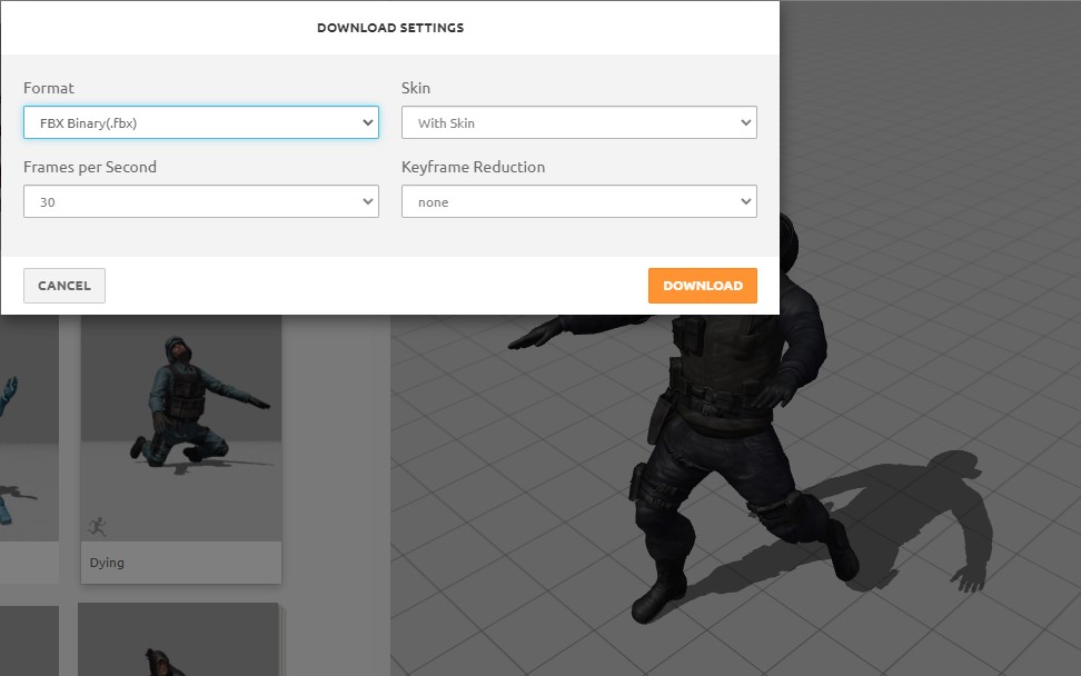

1 - Rigged, textured, animated character exported as FBX from Mixamo’s library

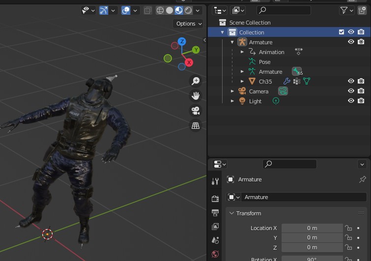

2 - The file as it appears imported into Blender

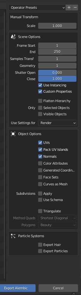

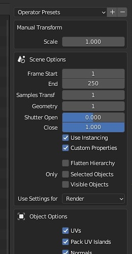

3 - The .abc file export settings used to export the scene from Blender

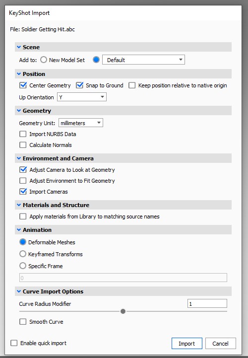

4 - The .acb import setting used to import the Alembic file into KeyShot

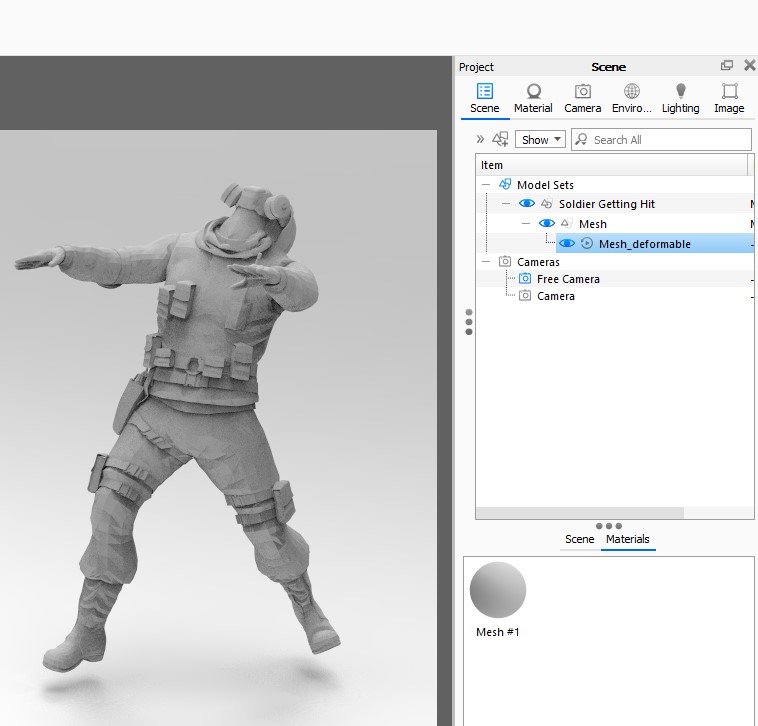

5 - The file as it appears imported into KeyShot. The animated mesh works when played using the Animation timeline.

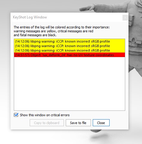

6 - The error message when attempting to apply textures to the mesh via UV mapping

At first I thought it might be KS removing the UV but I dug a bit deeper and I think things go wrong since the Alembic file format itself only supports one UV although Blender exports multiple (which should be handled well with other software).
When enabled, UV maps are exported. Although the Alembic standard only supports a single UV map, Blender exports all UV maps in a way that should be readable by other software.

Short story: KS 2023.3 can just import the FBX with the animation like you see in this clip

I installed KS 9 to test a few things but Alembic seems not the right format for the job. At least, the mesh from the Alembic file gets one material while the model actually has 3 materials. I managed to prevent the missing UV error in your screenshot but that doesn’t help much since KS sees the entire model as one object. That’s exactly the same in KeyShot 2023.3.

Importing the FBX does also import animation in KS9 but no deformable animations. So while it shows plenty of keyframes after importing the FBX it doesn’t animate.
